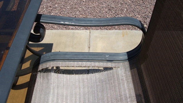

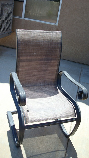

My husband and I just got a used patio set. The chair has a rip in the material and I'm not sure if it can be repaired. All I know is that the material is thick and course. It's almost like a weaved type of something. I attached 3 pictures that might help. Can the material be replaced or fixed on a certain type of sewing machine? :? Orrrrr should we just pay to have it done professionally , I'm soooo confused :? I'm just a beginner sewer but thought this forum would be of some help on this matter.
Picture of patio chair
Close up of rip
Rip on chair fabric

Boy, Dee. That's a tough fix. I'd say impossible given the stress the seat will be under by even the lightest weight person. Out of my league. Good luck.

Just did some more research. It's called a sling ( the material ) that goes on this kind of patio furniture, interesting. They have sites where you can buy the material but it's not cheap. Around $37 just to replace one chair. Good thing we got this set on a barter trade ;)

The sling wouldn't be too hard to make but I can't see repairing that. It may be a fun little project if u could find a nice outdoor fabric and use the doing as your pattern and sew new ones!

My husband just told me he found the material on Ebay for a much better price. And you just have to hem the sides. Will keep ya all posted ;)

There is a plastic "rope" (think piping) stitched in a casing that you will need to reuse. Often they are cracked into several pieces, but you can still use them. Be sure to use a UVR polyester (outdoor) thread. The channel that the piping slides through might need sprayed with WD40 or silicone to facilitate removal and installation. Not hard job at all. Good luck!!
