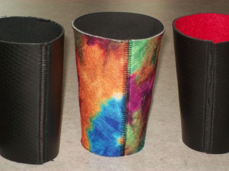

New postby Pudge99 on Fri Jun 14, 2013 12:17 pm
So I finally figured it out. I did a three thread set-up on my serger with loose needle thread and one loose one tight on the loopers. this is how it turned out.
Re: Need help with a technique.
New postby MartySews2 on Fri Jun 14, 2013 12:51 pm
Looks good, Gina!!!

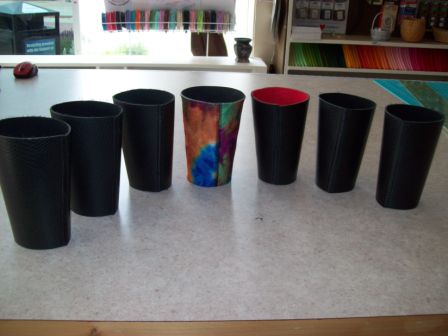

New postby Pudge99 on Tue Aug 06, 2013 11:33 am
Did such a good job that his son took them all, so he brought me more to sew. Good thing I took a picture of the serger settings required for this.
New postby sewhappyrtr on Wed Aug 07, 2013 7:26 am
What the heck are those?? they look like covers for glasses or something like that?? pretty neat!!
New postby MartySews2 on Wed Aug 07, 2013 10:29 am
Karen, I think that those are beverage glasses can coolers ... at least that is what I think that they are. Looks perfect for iced tea glasses.
