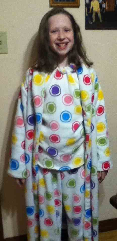

New postby temom on Mon Jan 02, 2012 8:37 pm
Well here it is with the rest of the ensemble. I'm not at all happy with the neckline, but she absolutely loves it, so I will to.
The shirt itself is bunched up because of what she had been doing. It does lay flat. The neckline - no way does it lay flat!
Silky Fleece PJ ensemble.jpg (26.83 KB) Viewed 4512 times

She does look thrilled, and that's what counts mom!

Theresa, that's cute. Love it & your daughter is happy so that's is what only counts.

She look warm and happy. I just love that smile.

She looks great in that wonderful outfit. Great for sleepovers and lounging around the house.

What a happy face!! She'll be warm and cozy for a long time to come.
