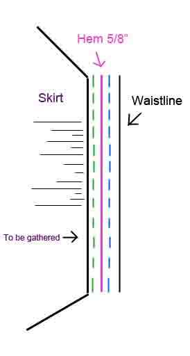

So this is another noobie question.. I'm working with a dress pattern that wants me to gather one of the hems, it asks to stitch along the hem line and then 1/4" INSIDE the seam.. I'm thinking that means closet to the raw edge?
Gathering stuff.jpg (11.42 KB) Viewed 7869 times
As in the blue line?

I think you are correct. It has been 10 months since I have sewn but if memory serves me, that is correct. There are a few ways to gather and that is the first method I learned. Have fun. I hope you have a good sewing book on hand. Readers Digest has a pretty good one and I am told the older edition is the better one.
Nice illustration. Did you do it in Paint.

Mrs B I gather just a smidgen away from the seam line so I don't have to worry about the gathering stitch showing on the right side then the second line of stitching is 1/4 inch away from that first row of gathering stitches. I have found if the 2 gathering lines are closer together they don't tunnel as much, and it makes it easier to have a neater row of gathers. Love your diagrams. So wish I could use our computer to its fullest extent. I'm still trying to figure out how to post pictures!!

I used Photoshop actually, little bit of overkill but at least I know how to use it!
sewingrandma wrote:I have found if the 2 gathering lines are closer together they don't tunnel as much, and it makes it easier to have a neater row of gathers.
Okay I think that makes sense! So I'm right in sewing the gather stitches closet to the raw edge? and then I should sew the gather stitch next to the seam and then next to that? Oh goodness I hope I'm making sense!

Mrs B, I can't quote either so just paraphrase what you said "so I'll sew closest to the raw edge". No, you stitch you first row of gathering stitches on the seam line then the next row of gathering stitches 1/4 of an inch away from the seam line/gathering stitch line. To recap, first row gathering stitch is on the 5/8 seam line (5/8 of an inch from the raw edge)and the second row of gathering stitch is on the 3/8 line (1/4 of an inch away from the seam line/gathering stitch line, 3/8 of an inch from the raw edge). Hope this is clearer. Remember this is how I find using 2 rows of gathering easier, others may do it differently.

Thanks Brockie, that makes sense!
