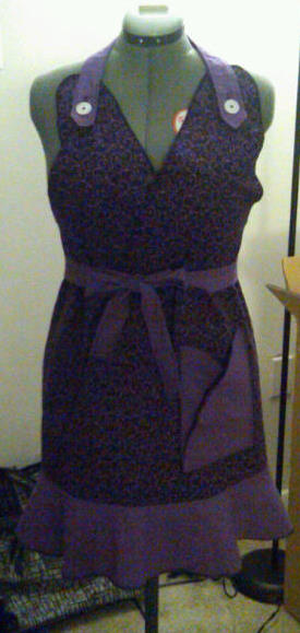

Here's my first project. It's my little sister's Christmas present. The ties are currently long enough that they can wrap around and tie in front...I should probably change that, right?

I think it looks cute with the tie in front. :D Great job! :applause:

Smilie, that is so cute. I love it & you did a great job. I love how the ties tie in the front.

Smilie, that is adorable! I also like it tied in the front! I'm sure your sister will love it. If not, tell her to send it to me! :D

Beautiful,love the front ties as well...
